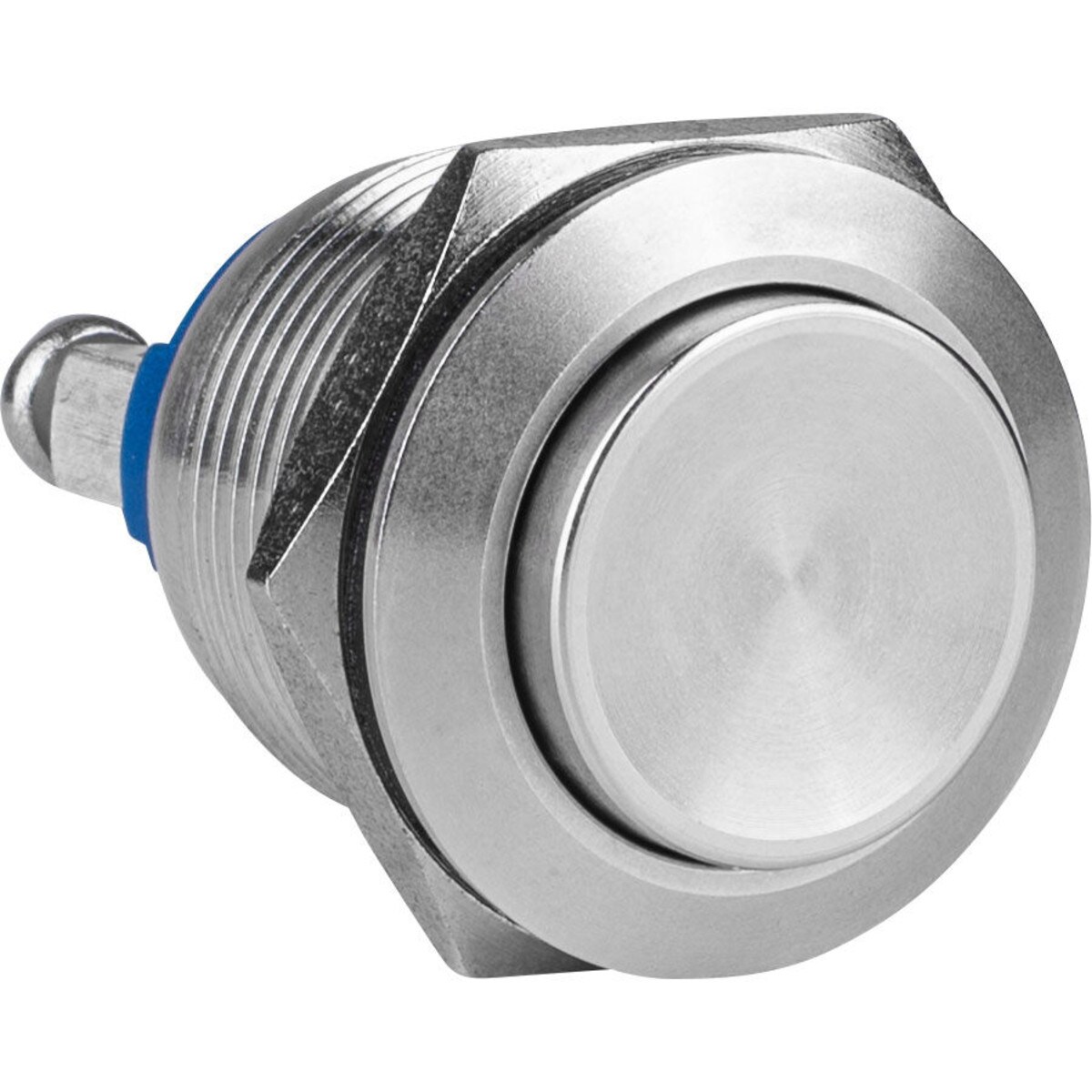

Would it be possible to have a power button on the front?
Definitely possible. For this case design I am open to rearranging things for best use. However I also don't want to make others feel they are missing out if they choose other offerings that don't have these things
Speaking of power switch on the front, would there be some unhappy side effect to moving the trigger-enable button to the front? (It acts as a standby button when there is no trigger, of course.)
Rick "whose other equipment lacks a trigger output" Denney
No, that's what the "power button" would be (standby switch, Power button, etc....same purpose). Only thing that kept me from implementing it right from the start of business was finding a good one with an LED at a reasonable bulk price.
4 usd without light ring (best for home theater imo).
I was trying to preserve the light ring. It is easier for those who don't want light to block it out or dim it, vs not having an LED at all for those who do want an indicator.
