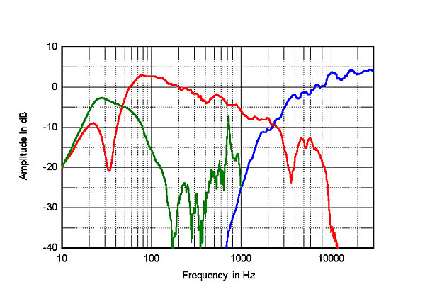

Here is a larger brother the Nautilus 802N. Data is from Harmann Gen 2.
Score improved significantly and with some light EQ this one will be good. Bass output looks great.
