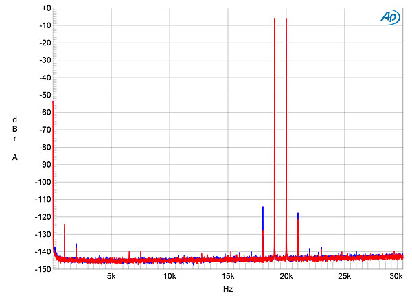

Here are some measurements of the Meitner MA3 by Stereophile that showed the ultrasonic garbage. The ultrasonic garbage are the "images" you get during the first order hold (FOH, aka stair-steps) D/A conversion when done NOS and sans filter.
[Edit] Compared to the Benchmark DAC3 HGC which is a properly implemented DAC.
