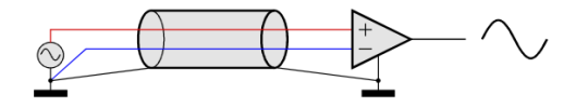

Will the sound quality and level I get with an XLR connection be the same as with RCA? For example, in db or bit
Sound quality with RCA will be the same, as long as you use the right cable:
rca-xlr_corr (1).png2conductorsor3 (1).pngScreenshot 2023-11-23 at 08.38.00 (1).png2021-11-08_11-09-17-1-2-1.jpg
Also see here:
While RCA would give you a 6dB quieter level than XLR, the JBL is designed for that as with its sensitivity set to -10dBV, the WiiM's output voltage of 2.0Vrms would be enough to drive the 308PMKII into clipping.
You are therefore not losing any quality or dynamic range.
View attachment 404126View attachment 404127View attachment 404128View attachment 404129
Also see here:
