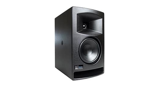

Meyer Sound Amie plus Sub
The seem to be in your budget.
Meyer Sound is somewhat known for sound quality and high SPL. I personally like them.
