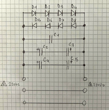

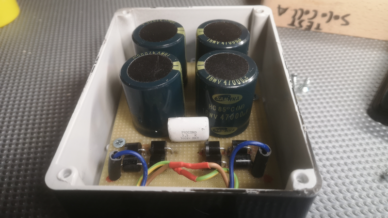

Good morning.
It had been a long time since I had to solve the problem of the humming toroidal transformer.
The 'latter is mounted inside a mosfet power amp built back in 1990 the noise was a bit random in the sense that sometimes it was louder and sometimes it was attenuated depending on the hours of the day, and it was audible up to the listening position, about 3 meters.
I built the circuit as shown in the schematic and I must admit that the hum was greatly attenuated by bringing the ear closer to the power amp, from the listening position you can hardly hear if there is any hum.
D1-D8=1000V /10A
C1=3,3uF/100V
C2-C5=47000uF/16V
