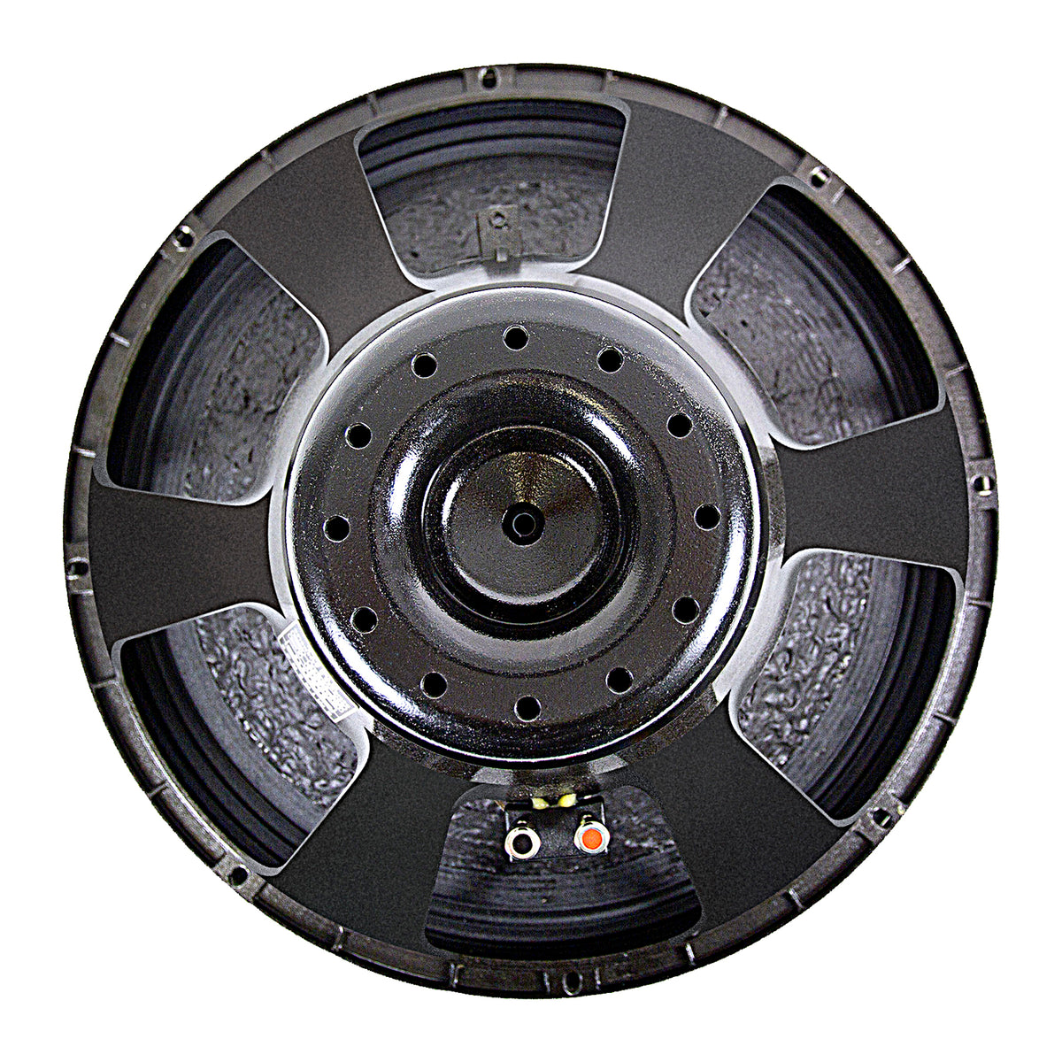

Real question is Eminence NSW6021-6 vs BMS 18n862.
Any reason to go with BMS if you have the money for NSW?

Can someone make a suggestion which driver are Beckersounds using in their 18 inch sealed enclosure as volume seems like not more than 4cf and is perfect for me to build 2 front boxes for my cinema room : https://beckersounds.de/wp-content/uploads/2024/08/b1002-Datasheet.pdf ?
Possibly:
If you have plenty of Xmax, DSP, and ample power, you can get away with a smaller enclosure.
