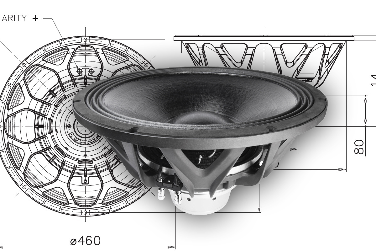

Somewhere i read Faital is a bit pricey for what they offer.
No, that's far too general. The woofers usually offer a very good price-performance ratio.
I don't know where you live.
If you can order here, 429 euros is a bargain for one of the best 18-inch speakers.
Why, thank you brother! I was checking my vendors and they had this speaker at 6 or even 700 euro. Ill run it in WinISD see what goes.
I think it simulates beautifully. As far as that's concerned, my thumbs are up. :)
needs a big box though. WInISd starts at 210 liters...
