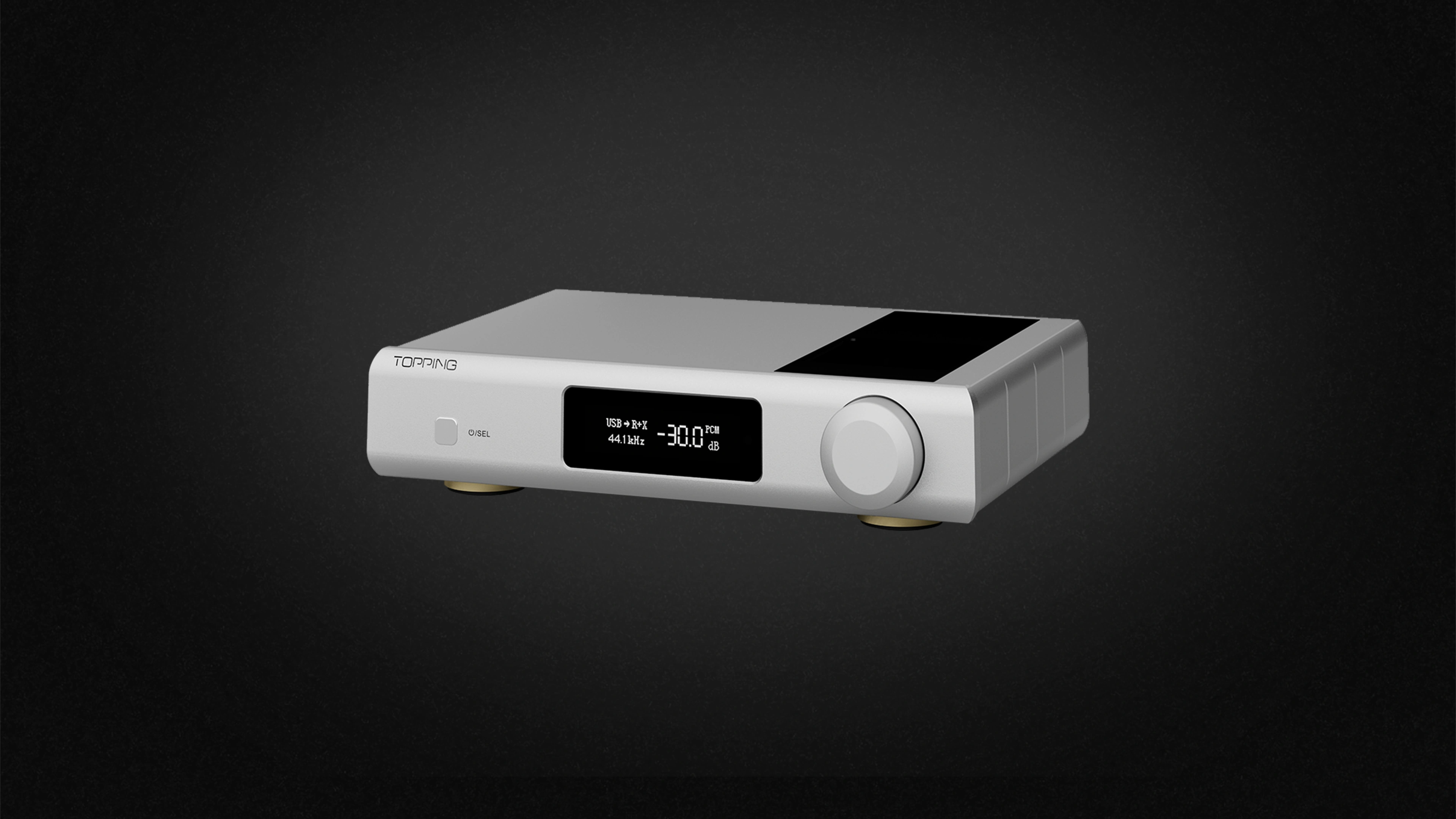

1 bit DAC launched by TOPPING
The Topping D90III Discrete has been released. Measurements look fantastic with a 10-band PEQ. Is this worth buying if I need a good DAC/Pre-amp?
I wonder eq probably only with USB inputting?
It's on the product page as well as an * on one of the images.
What we don't know for sure is if the eq is global like the D50 III, or if it can very per channel.
Does not appear to be variable by channel. What I'd like to know is how this is applied...is it applied to PCM material before conversion to DSD/1-bit? So is this EQ unable to be applied when feeding DSD material? Or does it convert to PCM, apply EQ, then convert back to DSD before converting to analog?
Also...in Preamp mode, is volume control in the digital domain? If so, is this done with PCM signal before conversion to DSD/1-bit?
