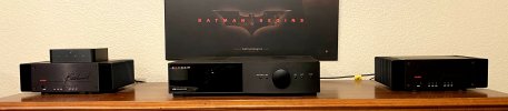

I'm with @amirm on this one. There's something about symmetry. Yeah the Wiim kinda throws things off but still; I love the synchronized lighting in the AHB2s.
