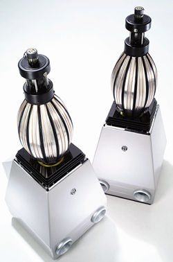

Muraudio PX2 Omni ESL:
The omnidirectional (in the horizontal plane) Muraudio is at the opposite end of the electrostatic spectrum from the Sanders Sound hybrids, unfortunately I've never heard a pair. I presume they'd have the same room-interaction challenges as most omnis, but with the inner detail and articulation potential of a good electrostat.
