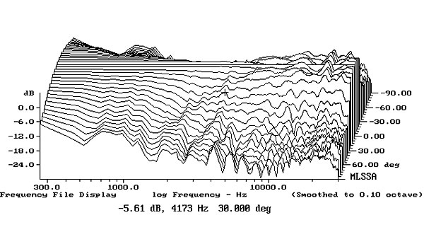

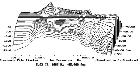

Apart from the D&D and Linkwitz's LX521, only a few ESLs, 4/5-way horns and maybe some open-baffle designs can maintain constant narrow directivity all the way down to the bass:
Dutch & Dutch 8C (wave-guided cardioid narrow baffle box with rear woofers)
Kef Blade 2 (wave-guided coax narrow baffle box with side woofers)
Jamo R907 (open baffle)
MartinLogan Montis (planar dipole above 300Hz)
Avantgarde Uno Nano (horns above 350Hz)
source: https://www.stereophile.com/
