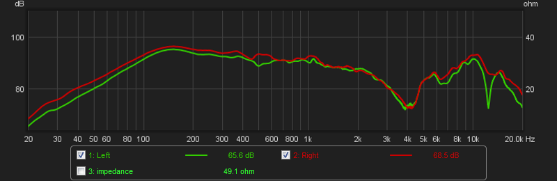

T50RP:
measured on the same rig T60RP:
The T60RP seems to have better treble extension and a different treble peak.
Could be because of different pads (real leather vs pleather for T50RP)
The T50RP mk3 pads also differ from the T50RPmk2 pads.
Maybe someday someone sends one to me to be measured.
The T60RP do have the 'comfort strap' as well.
As a reference measured on the same rig Audeze LCD-3
The only way to find out how different mod versions sound is by measuring them all on the same rig.
Going from a plastic to wood enclosure may make a small audible difference but won't be visible in measurements.

As long as the shape and volume of the enclosure are basically the same the differences you are most likely to see would be in the CSD and maybe low frequency distortion.
They could be visible in a CSD but certainly not in the FR plot. I reckon some wood resonance (or plastic one) could be visible if the material is very thin and not well damped and resonates longer than the driver itself.
What could be interesting is 'tapping' on the outside of the headphone with a metal rod, record the sound and then analyze FR and time components to see where the material is doing something. Someone probably already did though.
To really make wood 'sound' it would have to be really thin and 'flappy' and not quite thick.
