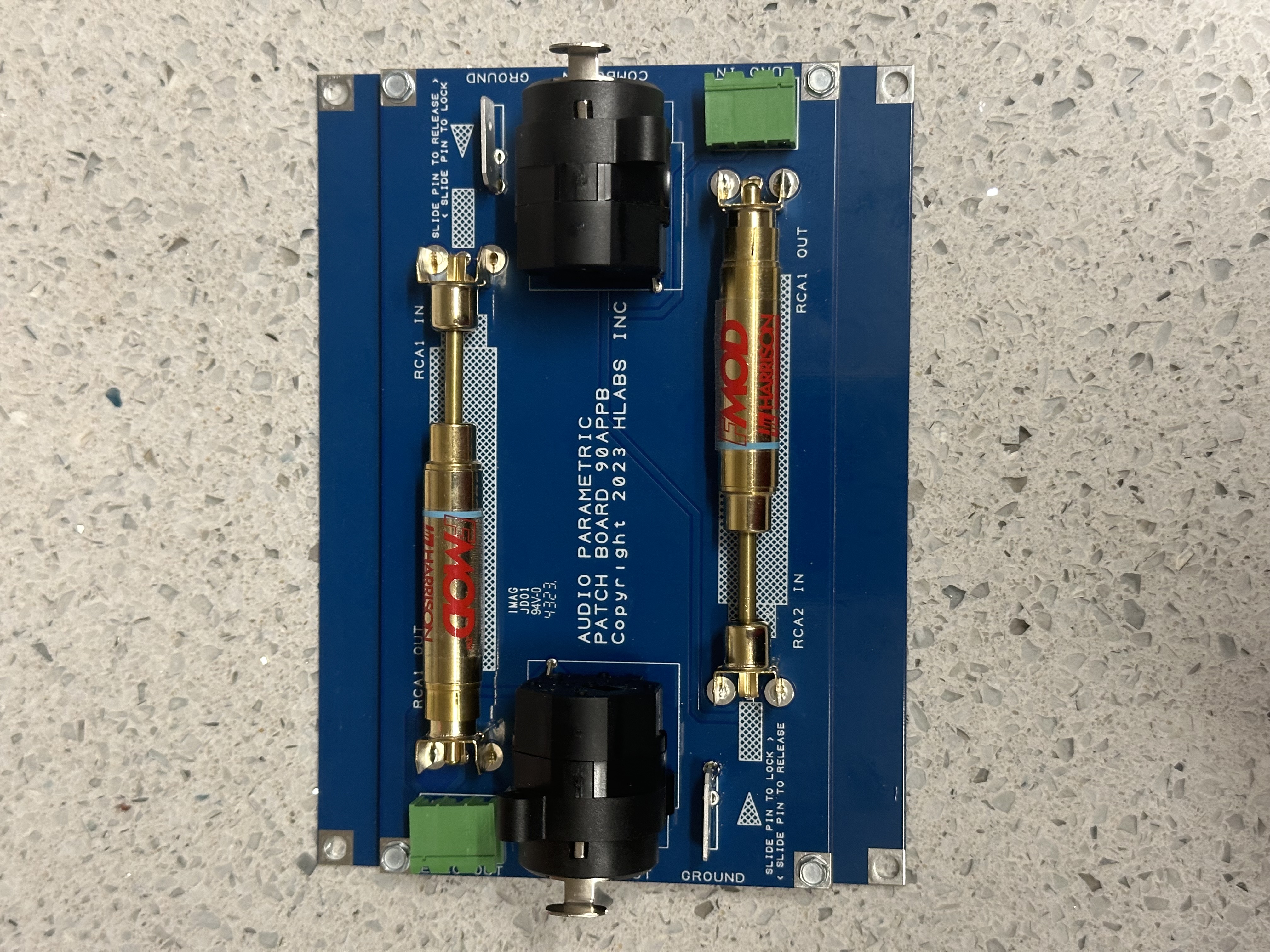

This FMOD Passive Line-Level Crossover (Balanced XLR) is pretty cool. A little on the pricey side, but finished product, ready to purchase. ie: use the High Pass 70 Hz ones and the PA5 will now have more power available for 70Hz and up since it will no longer need to push below 70Hz . Great combo if using a Subwoofer.
Or could build some with better parts too, good Teflon caps...

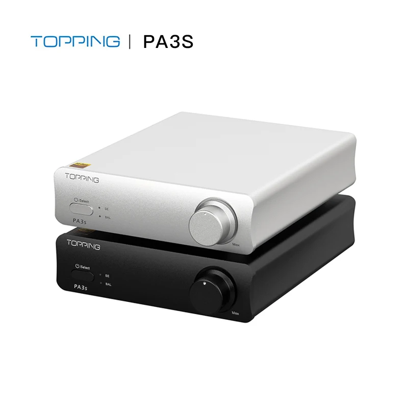

You could watch the Topping PA3s, I had a friend buy it. It has the DAC Topping DX3 pro. The PA3S has two inputs, one XLR and one RCA. My friend has several amplifiers and he loves it, he listens at times to quite loud music (87db hp) and the amplifier holds up well. The chips is MA12070 doubled.
US $149.00 | TOPPING PA3s MA12070*2 fully Class D balanced amplifier TRS balanced RCA single-end input power amplifier 80w*2 hifi digital amp

It's up to you, the A5 is an IcePower and not the best model.
The Topping PA3s is a 2x ma12070 and surely more musical. I have the Sabaj A20a on my second chain, and the MA120470 is really good.
