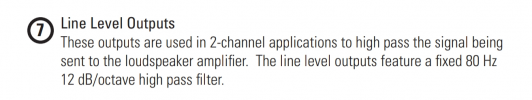

SVS SB 1000 hooked up via speaker level connection. Appreciate the insight.... I'm leaning towards it's not going to work but as you point out it's all about what going on inside the box.
It might make more sense to use the RCA outputs from my subwoofer if I wanted the VU meter to capture the signal from non digital sources i.e. turntable.
I'm not sure if the crossover in the sub effects the RCA output signal? In other words would the VU meter only read signals below 80hz if that's where I have it set on the sub.
From the user manual:
What's not clear is if the Line output also works when you use the High Level input. That you'd have to try yourself.
