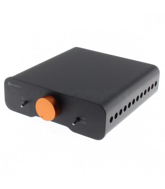

Fosi Audio will be bringing out a loudspeaker amplifier with differential (balanced) inputs and a 12 volt trigger input in December 2023 and one vendor has posted a listing
Fosi Audio says they are developing a preamplifier with differential (balanced) outputs and a photo of the suggested back panel shows a 12 volt trigger output
I have no idea what Fosi Audio will charge for this differential (balanced) preamplifier. The price for the ZA3 amplifier at Audiophonics is lower than I expected - for a loudspeaker amplifier with a differential (balanced) stereo input and a 12 volt trigger input.
Perhaps a Fosi Audio ZA3 (or two) amplifier and this upcoming Fosi Audio preamplifier would fit your needs
