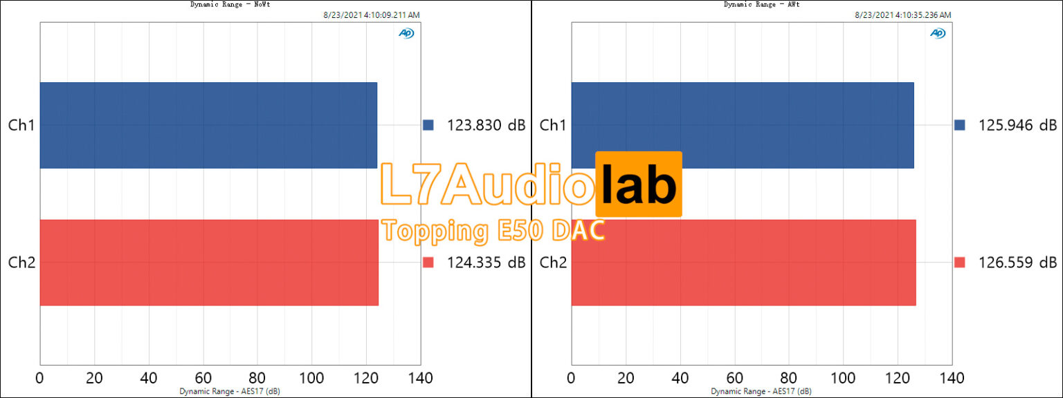

I don't think that's audible? However, balanced has other advantages such as eliminating ground loop hum and connectors with better mechanical integrity. I won't buy another source component without balanced output.
This depends more on the whole audio chain than the DAC only, anyway more DR - and less distortion, of course - you got at source more the whole system will react accordingly (that means "audibility" is not strictly necessary) IMHO...
Anyway, except "phisical" needs (hums, links, etc), I do use my E50 balanced outputs for mixing sessions with active speakers too.
