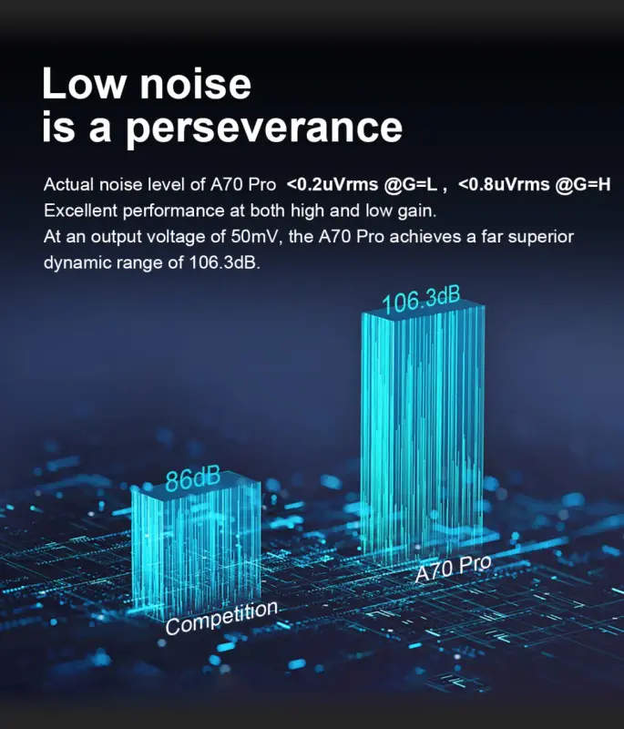

Surprised 50mV is measured to almost 93dB when they advertise it as even better, way better than anything else really
As explained, this number is analyzer limited. Topping uses an external noise amplifier to get around this factor.
Ah, thank you. I should've read more carefully..
