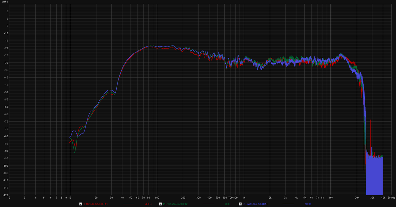

So apparently this woofers sensitivity is increased compared to the sample speaker I used to set up the DSP. I don't like it, but that's what you get when you don't want to pay big dollar for better QC.
Fortunately we added high (2kHz, Q0.35, +-2dB) and low (110Hz, Q0.7, +-2dB) shelf filters to adjust the speaker to ones taste via the dip switches on the back. With the low shelf set to -2dB it is possible to mostly remedy the increased sensitivity of the woofer. The attached measurement is already with this -2dB low shelf filter active. I wish I had set it to +-3dB :D
Also I have to add another disclaimer: It's really tricky to merge the near- and farfield measurements of a 3-way speaker. The farfield measurement was corrected for groundplane effects and the nearfield measurement of both midrange and woofer was corrected for baffle step. I'd love to see a real anechoic measurement or a nearfield scan extrapolation of the X8, but for now this stitched measurement is the most accurate thing I can provide.

That looks quite serviceable, with the exception of some unfortunate diffraction around 10KHz.
