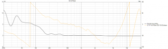

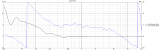

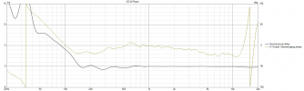

The A series is flatter below 400Hz than the measurements above make believe as there is not enough information with a windowed measurement. I attached one of the nearfield measurements of the A305 from during the tuning process as an example. The hump at 50Hz makes it very obvious that this measurement is missing the port data, the rest is as flat as it gets, but you don't see that in gated farfield measurement at all.

My pleasure! These were the first speakers I adjusted with a few filters (and some group delay correction with the A series). After these I was allowed to toy around spend time with the next speaker for a whole lot longer, but it's still a few weeks until it gets released.
