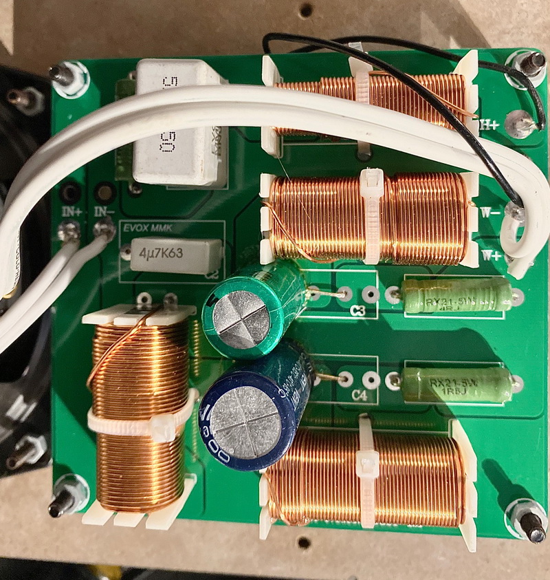

I wonder if they cheaped out on the crossover for this design? There are quite a lot of components in the original design. To my memory the original LS3/5A used a polypropylene cone, which is kind of the recipe for most low-cost commercial speakers you can find in HiFi magazines as you can get away with a first order crossover without peaking the response, so they might have just looked at the combined response and said 'good enough', even though it really isn't ofc.
Looks a lot cheaper than the original type, using electrolytic caps to set time constants is never a marker of quality... They may even be going a bit dry, losing value, and pushing the Xover point up, resulting in more out-of-band driver distortion. Pure speculation on my part, though. From memory, crossover impedance can dramatically drop if unloaded at certain frequencies, so my bet would be on those electros causing that shocking 1.7 ohm impedance dip. If there's an LC section feeding into an electro and it goes dry then it will be unloaded and resonate, causing a horrible impedance dip like the one in the graph.
There are so many variations over the years with different versions, clones, tolerances and ageing that people who think get THE LS3/5 sound can get quite different "intepretations" of it. ;)
The measurements of Stereophile in the past had also shown that:
Isn't the placement of both coils in the top right corner also pretty bad from a xover designer's point of view? I know it's probably the least of the concerns, but still.
Good spot! It's pretty ugly to look at. Usually when serious class B amplifiers are designed with two channels on the same board the output/stability chokes are oriented at 90 degrees from each other to avoid transformer action at HF inducing crosstalk.
Whether it makes a measurable difference (in terms of the acoustic performance of the speakers) is somewhat debateable, especially given all the other ills this design is clearly suffering from. As you say, it's a marker of poor attention that serves as an accurate omen of what kind of overall result we're likely to get...
