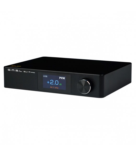

Tous les sites semblent dire 9038 Pro pour le SU-10... semble que ce soit le SU-9 Pro qui a le 9039;
Toutes les annonces indiquent 2x ES9039MPro. Sur la photo, nous voyons un ES9039MPro.

Toutes les annonces indiquent 2x ES9039MPro. Sur la photo, nous voyons un ES9039MPro. Translated: All listings state 2x ES9039MPro. In the photo we see an ES9039MPro.
Yes... for the SU-9 Pro, not the SU-10 which this review thread is about. There isn't an SU-9 Pro test/review thread here... yet. I hope that's as clear as mud now. :p
