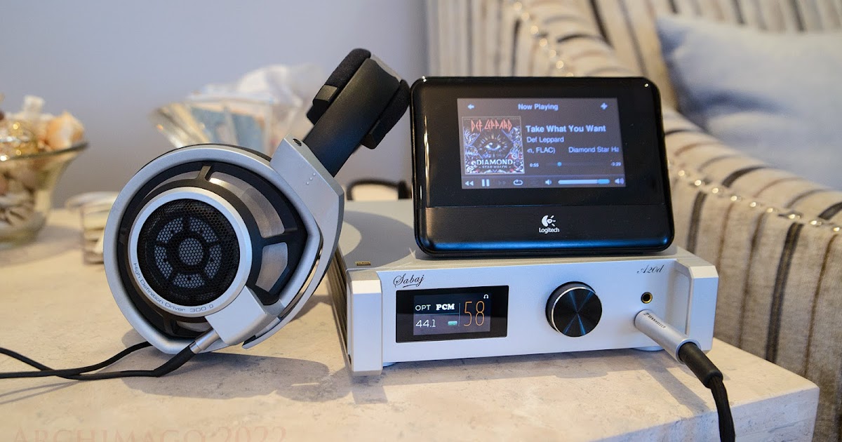

It is really good looking combo with HD800
