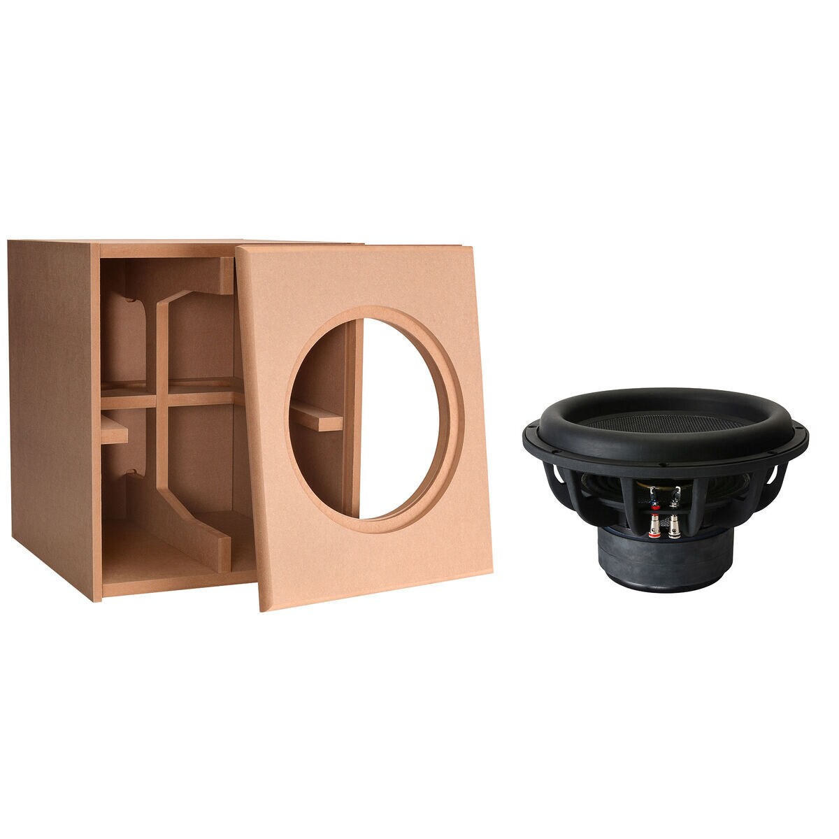

It’s just a kit with RSS315HFA-8. Only the woofer is already €330, which is to expensive. The MDF box is another €135 (flatpack). Otherwise, nothing special really.
Preferably you go for 4 Ohm drivers though, otherwise you’ll loose some amp power.

As a cabinet, I would be inclined to get one as a kit as I don't have much time to work with it, however I only see the Denovo, which is also sold in Europe by SoundImports, but 250€ is not a bargain.
Could someone tell me others?
I saw that :oops: quite a steep price! Try your local carpenter?
