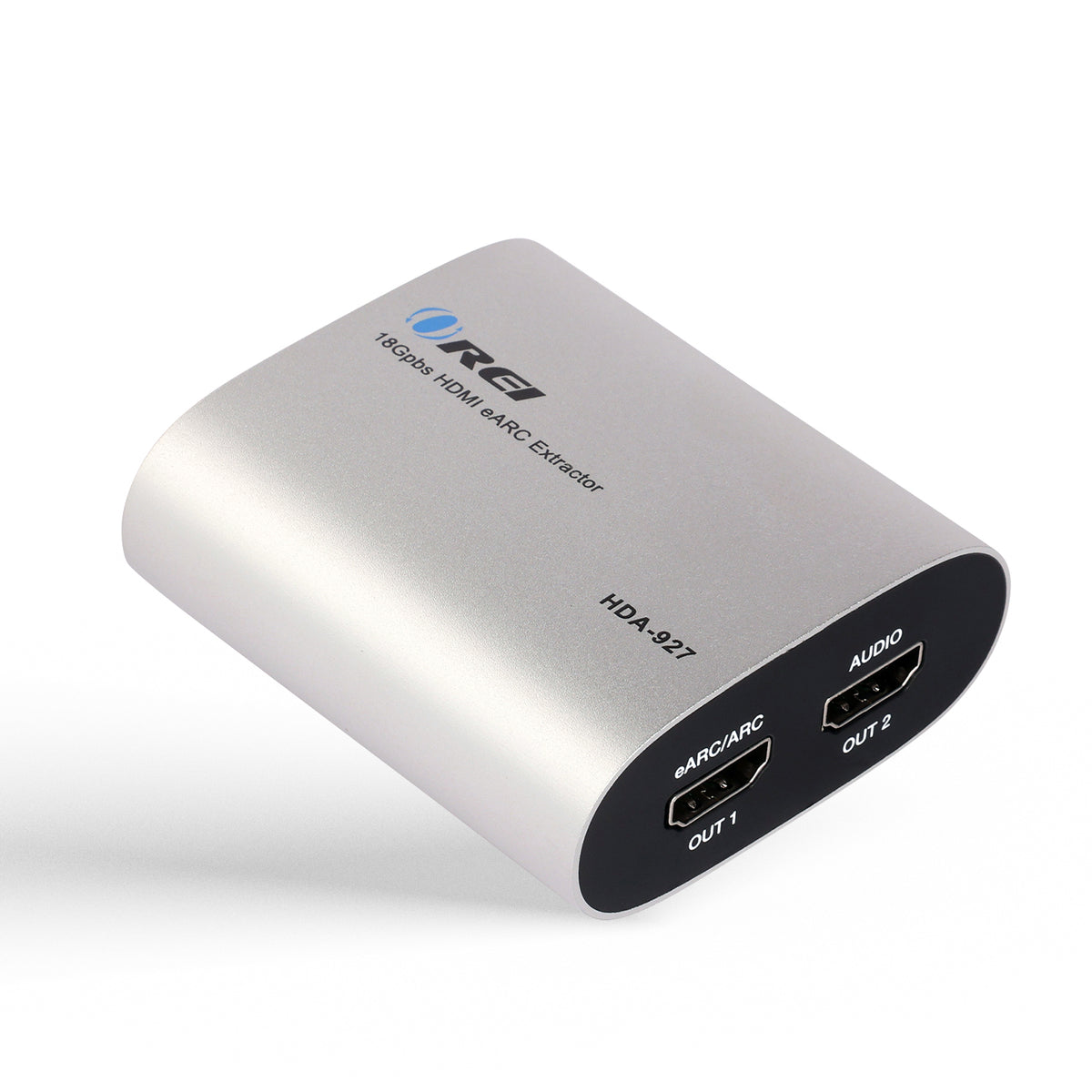

Those are not eARC compatible though. You have to put the signal through them and then to your TV and that will probably mess up a bunch of stuff such as Dolby Vision etc.
Expensive, but this will accept eARC and can output a 2 channel PCM signal over optical. Supports HDR, Dolby Vision, etc. They also make an 8k one with VRR 120hz support.

That's still the type you put before the tv. You can tell because it only has hdmi in and out. Another tip off is the marketing explaining what video resolution it can handle (as it has to pass the video to the tv)

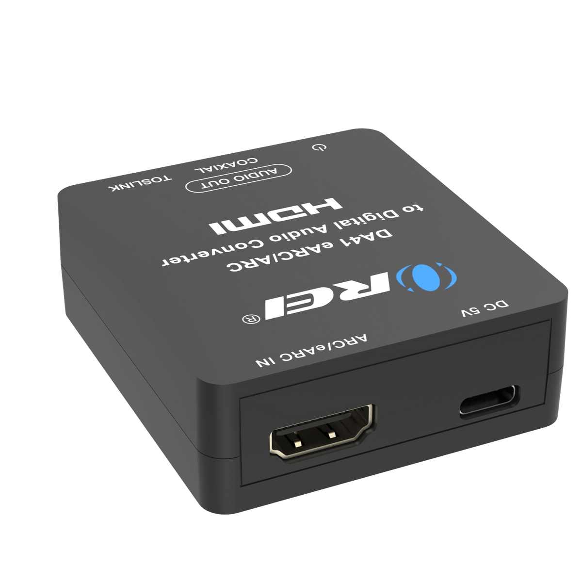

what you would want is something like this. it has eARC/ARC in and optical and coaxial out.
If the tv manufactures all had decent optical out, or dacs had eARC/ARC in, you might not even need an AVR with a modern smart tv.
you would feed your cable box, cd/blu-ray player, game console etc into the tv and the tv would out put just the audio stream via optical or eARC/ARC to your dac. Your other digital devises would feed into the dac. whatever is down stream of the dac is up to you.

I am getting audio cutouts when using the SPDIF output of the TV. I have even tried two eARC HDMI audio extractors (links below), taking the SPDIF output from the eARC audio extractor and connecting it to the optical input of the Loxjie DAC. While the cut outs are less frequent, they still occur.

These are eARC extractors I tried:

The analogue out on these LG tv's is usually a cheap headphone out and sounds hissy and noisy as all hell. I have an LG C9 and use that same Orei eARC extractor over coax with no dropouts anymore. My DAC allows for changes in PLL but I get no dropouts no matter what I have it set at.
Have you tried Coax on the Loxjie from the Orei? Coax cables can be bought for cheap (monoprice, etc).
