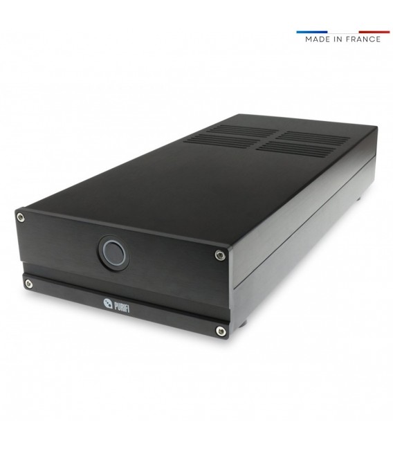

from Audiophonics website (on 1et400)
“A Texas Instrument LM4562 OPA per channel is used, these are very low distortion AOPs offering the greatest transparency with a very low THD. They are mounted on socket allowing their replacement if necessary”

I thought that was used on the AUDIOPHONICS MPA-M400ET Power Amplifier Class D Mono Purifi 1ET400A ?
My memory might have failed me, but now I can't see any mention of the OpAmp used on the HPA-DM750ET?

Audiophonics seems to use 4562 also in 1et7040, but you are right, no mention of op-amp used ins 9040 specs. Maybe they come with skmething new for 9040.
One LM4562 OPA per channel, according to the updated product page of the HPA-DM750ET.
Indeed. That's a little disappointing, though they say it's mounted on a socket.
It is a DIP8 socket though, so you can replace is with an OPA1656 if you want better driving capability, but also slightly more noise. The discrete opamps for that socket are not better. The Weiss uses a pro opamp socket.

Yes we selected a versatile and common model that offer good performances and availability in DIP8 format.
What models would have been more relevants ?
Any suggestion welcome for future updates.
