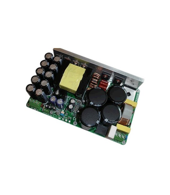

What is the recommended power supply for max output for these 9040 modules when used as monoblocks?
Dual rail 45V (I.e. providing 45 and -45V). That’s where the “90” in the name comes from.

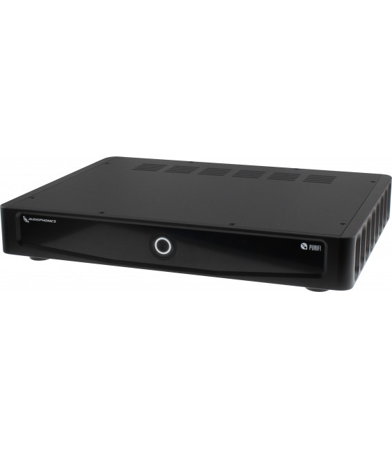

Audiophonics are taking orders for their 1et9040ba two channel amplifier (for 2990!) which seems to use the same slim chassis as their other Purifi & Nilai stereo amps:
I noticed that Apollon say they use the Hypex SMPS1200A400, but that's a 64V supply, which I think is wrong for 1et9040ba.

I asked Audiophonics, out of curiosity, what they are doing for the input buffer. I hope that they are not reusing their single opamp buffer, because that would not give justice to the 1et9040ba, but I fear that this is exactly what they are doing.
Audiophonics say they use the Hypex SMPS1200A180, which is a 46V supply.
The spec sheet says +30V to +45V max.
It's low voltage because it's a bridged amp.
The Connex SMPS2000RxE could provide more current. It's only 40V, so less 8 ohm power, but I think Connex offer customisation options.
There are probably some suitable options from Micro Audio, but I'm not sure I want to go there.

If I did the calc right given the 2 x 1200 watt@2 Ohm with the given max efficiency of 96% for the amps + PSU ,this case should have the ability to dissipate more than 150 watt.
It certainly does not look like it given the size and the small heatshinks and I don't believe they use active cooling.
