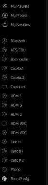

Under Source Setup on the M33 you don't see any other HDMI entries either?
What's weird is that I see all the HDMI entries under source setup. I just don't see any picture on my TV screen. I have tried different HDMI inputs and different HDMI cables on my TV, but nothing seems to work. NO such problem on my C658. Makes me reluctant to purchase any more NAD products in the future considering their lack of support.
I guess that's all to it:
Link
This is what I see under source set up (please see attached). Does this look correct?
I tried several cables, all certified but still no luck. And each of the TV HDMI inputs work as I tried them with other sources. This is truly a puzzle, which I am not happy about.
Just to make sure there was nothing unique to the Sony TV I was using, I also tried this on a Samsung TV. Same problem --doesn't work. I wish NAD would discuss this a bit more since there is clearly something odd going on here.
