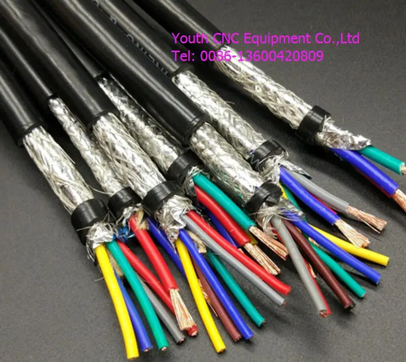

But Shielded cables and Ferrites exist.
Often used so no RFI/EMI escapes the cables but they work of cause both ways.
Farrow-Cable-RVVP-1m-High-quality-0-3-mm2-5-cores-Shielded-Cable-for-spindle-inverter.jpg
