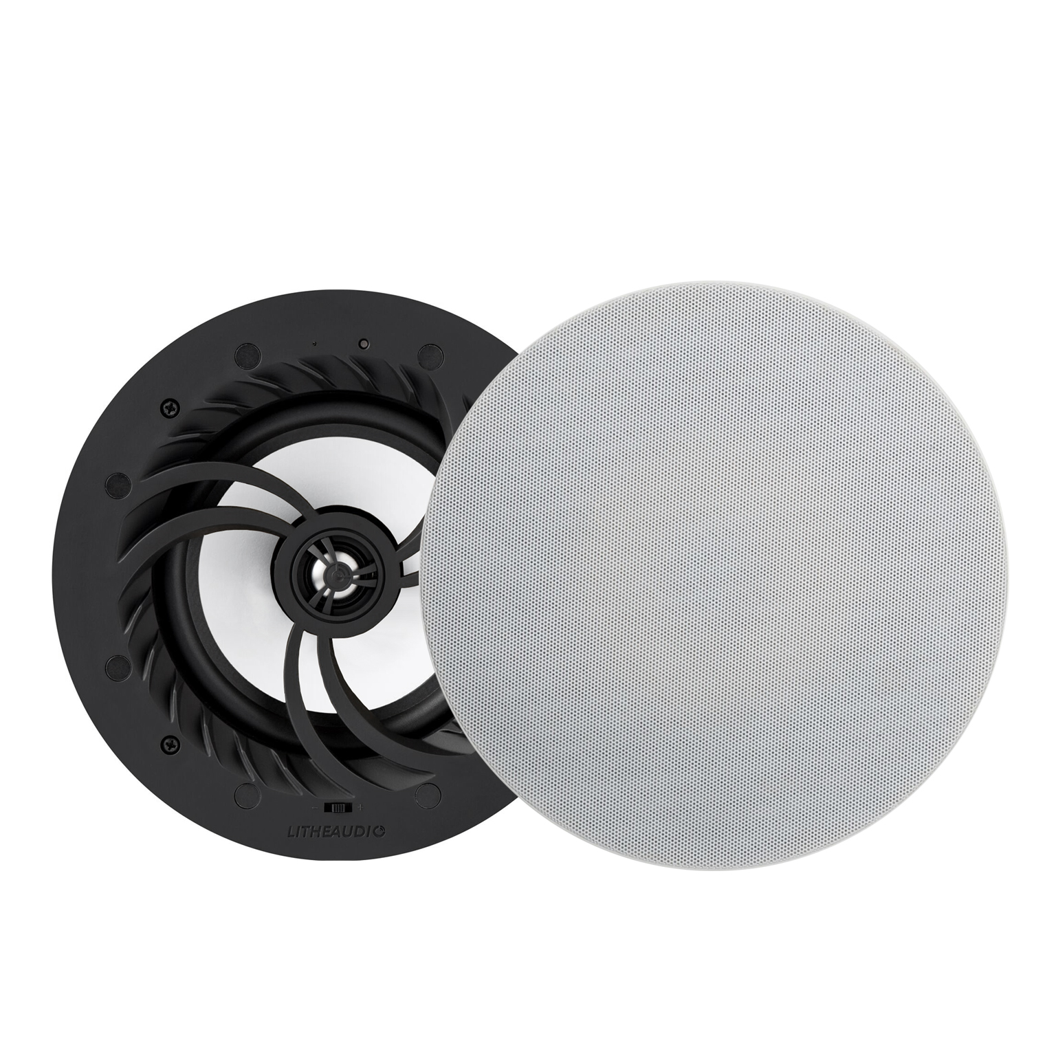

Active in-ceiling speakers, with integrated chromecast, may be the solution. Here you have an example of such solutions: https://www.litheaudio.com/wifi-multi-room-ceiling-speakers.html
Do you have any experience with speakers like this? This one looks really interesting as it even can be integrated in Loxone / KNX. Unfortunately, the only review I found about them is not really promising...
Yes, I have a pair of such speakers in the dining room. They provide full functionality such as chromecast audio. The sound is not top notch, but for a ceiling speaker, they do quite well. I use them both from my phone, directing music to them from Tidal, Qobuz and Spotify. They also work with Lyrion Media Server, after installing the castbridge plug-in on the server.
