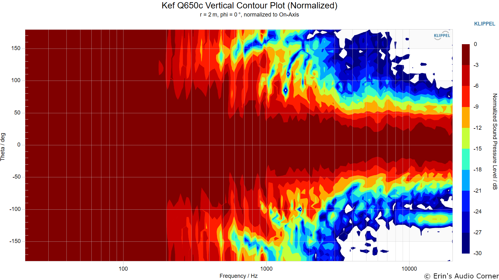

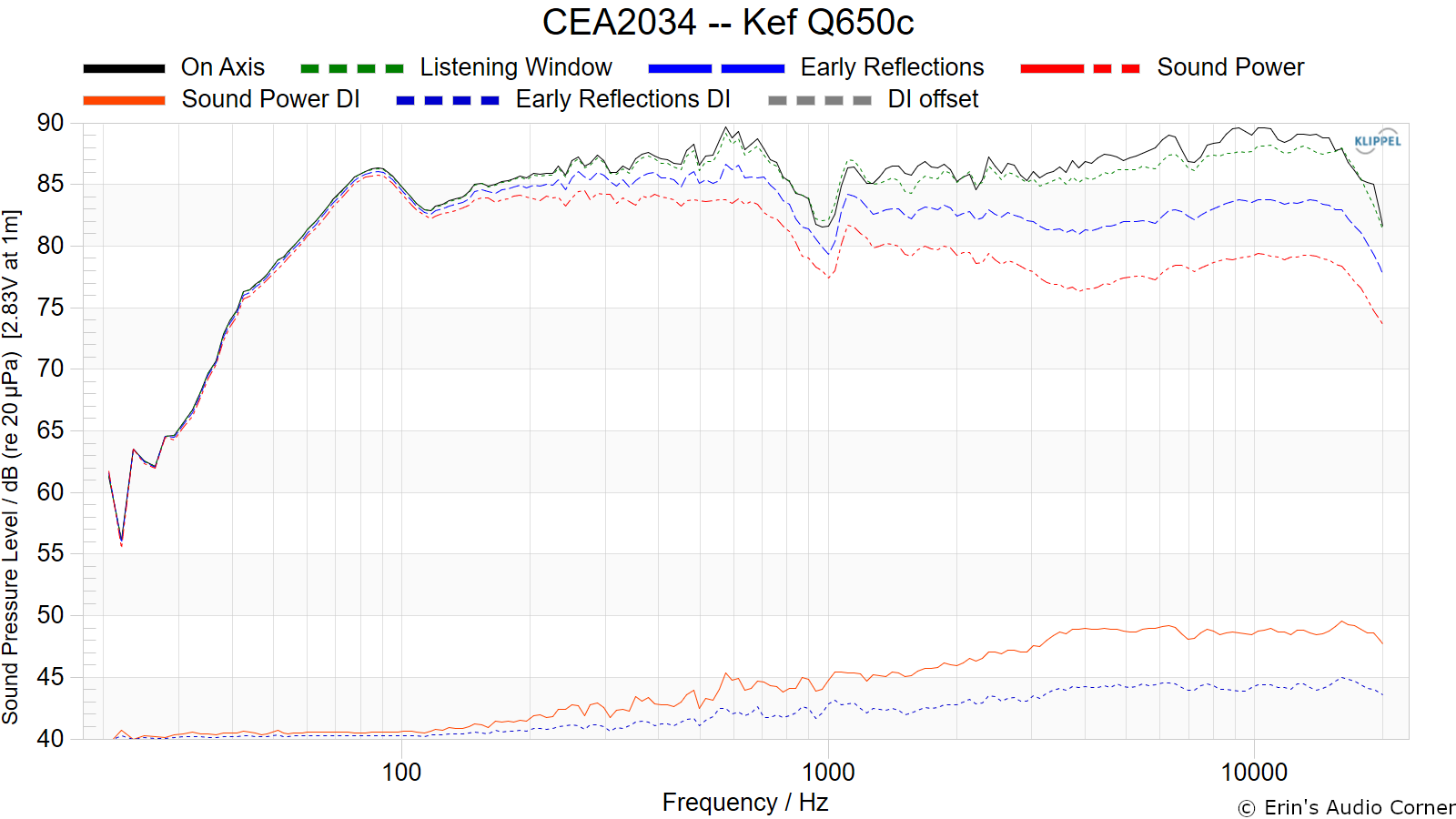

Disappointing how bright this is out of box. Excellent directivity as usual though, so in theory room EQ(or manual EQ) should bang this into decent shape at least. Definitely a lot worse than the R2C.
That's too bad. I was hoping this one would prove to be a hidden gem. At least it is correctable, but I generally dislike using correction throughout the entire FR, which this would need.

Half the price of the R2C and Audyssey fixed it pretty well (psychoacoustic smoothing, with sub). Increased 100-200Hz in app, didn't measure again.

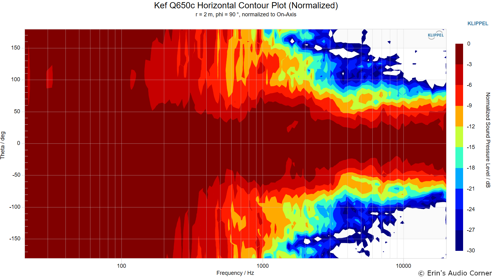

Horizontal directivity is like mtm centers at only 20deg? It is more sensitive than r2c though. R4c would be best but the price...
