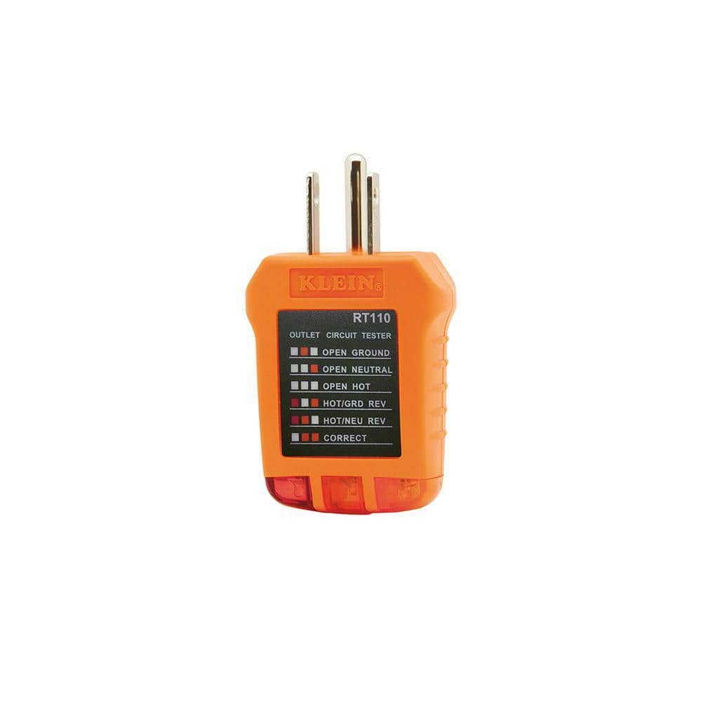

Email JDS they will get right back to you. You power transformer should be 15 or 16v. 18.7 is too high. Get up cheap tester at Home Depot and plug it into your wall outlet and make sure your grounds are okay.

Outlet is grounded ,I have tested using a mains tester plug.
