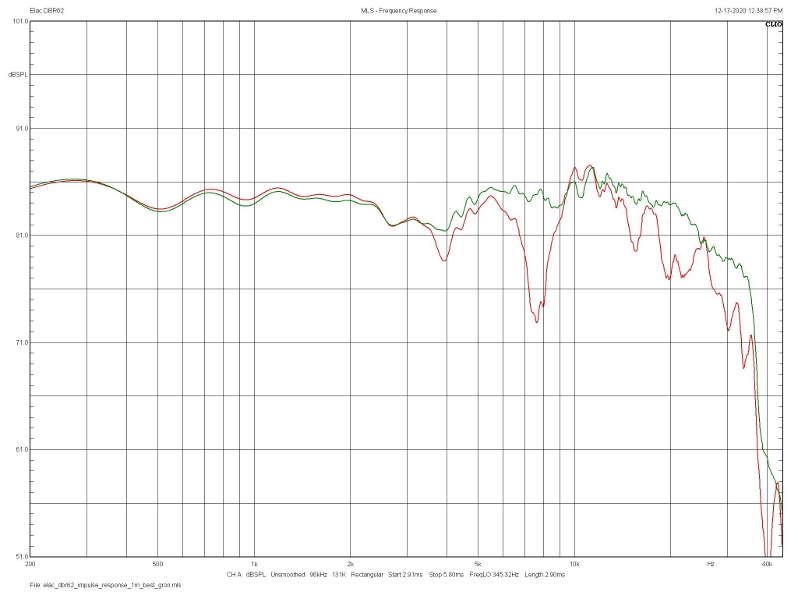

*this has been referred to in some posts as the tweeter's waveguide. I believe the waveguide is the conical section further in - the metallic grille is just protection?
Yes.
  1. Cloth off, Tweeter grille off
It looks miserable that way: https://www.audiosciencereview.com/...r-62-speaker-review.12232/page-65#post-705130
It's clearly designd to be used with that grille on. Most Elacs of old were designed to be used with the grills (both metal for the dome drivers and cloth) on as well.
