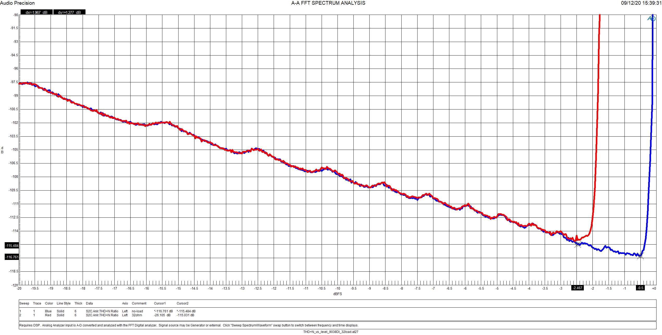

Most portable amps can deliver much more power in balanced. For the record I have the A2 Noire's and E1DA 9038S and it's plenty of power.
I don't think you understood the review/graphs correctly.
The channel imbalance reveals itself only far into clipping territory. It is for all intents and purposes irrelevant.
