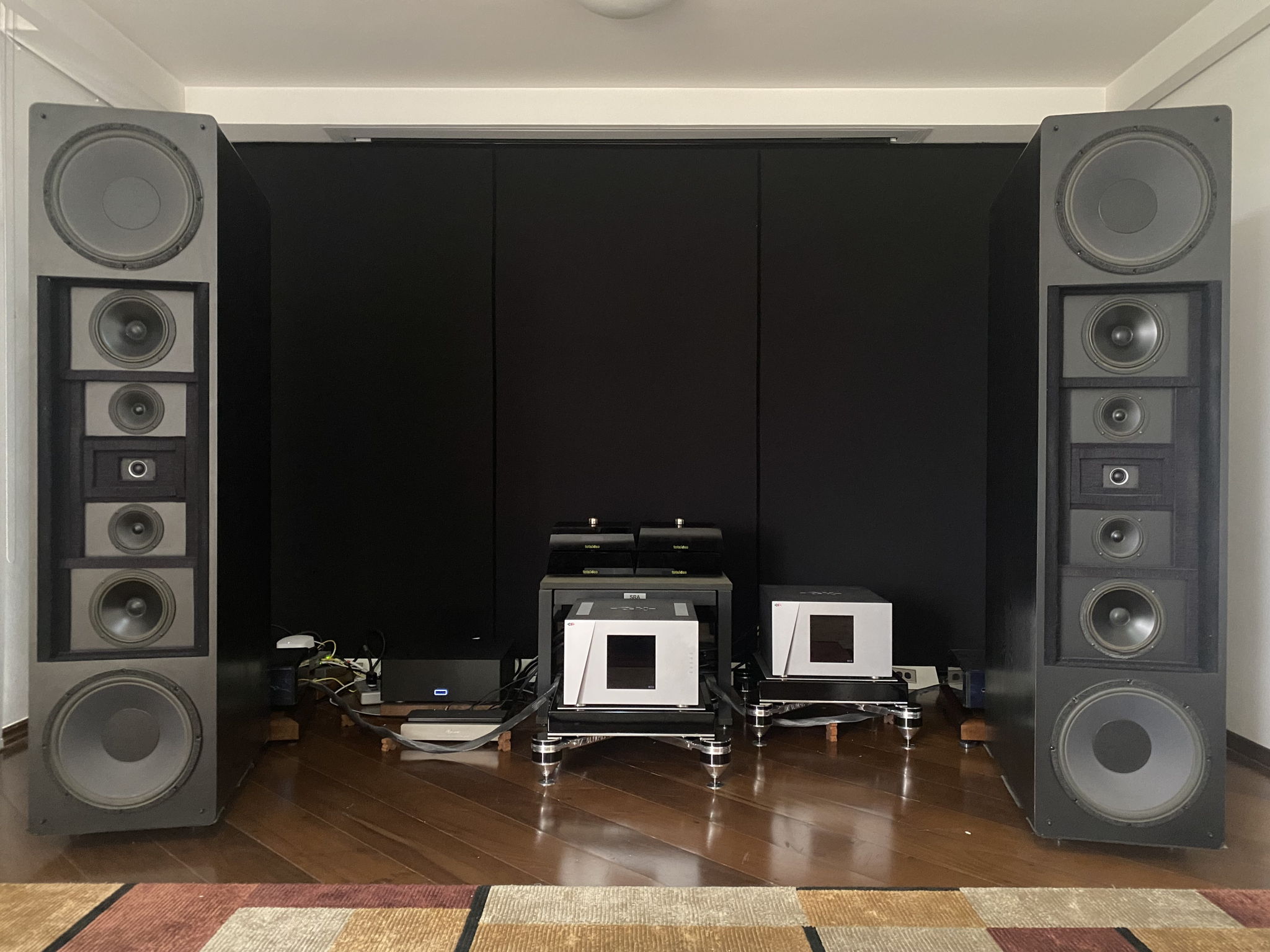

I have a highly modded pair of Dunlavy SC-VI, and the crossover frequencies (original, I didn't change the circuit) are aproximately 70Hz, 1Khz, 2Khz. So the two 8" drivers operate from 70hz (and even lower) up to 1Khz, quite different from an SC-IVa for example. I had a pair of SC-V before, and I am curious about the SC-V crossover frequencies.
My system:
