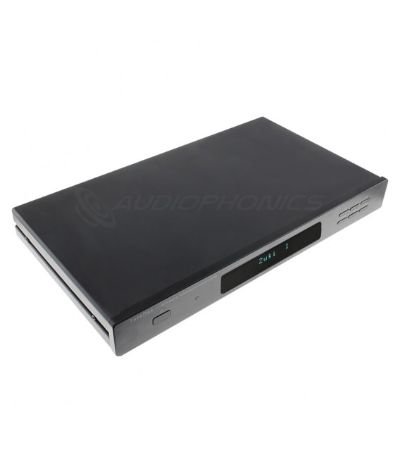

Good thing is that stuff like this are coming out every day,maybe not what the OP asks but low cost,multiple inputs are on demand,so example.
Inputs1x USB-B
1x AES/EBU
2x Optical Toslink
2x Coaxial
4x RCA
Outputs1x RCA
1x Balanced XLR
We don't know how it measures or the reputation of the company,reliability,etc but it's good to see at that low price range.

@Sokel - I'd never heard of that brand or unit, looks very interesting as well. But unless I'm not looking at the images and specs incorrectly, I think it has only analogue outputs.
