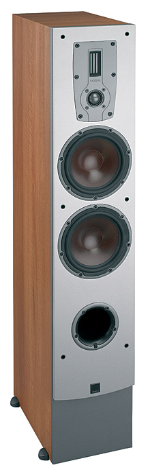

Bought Dali Ikon 6. Replaced capacitors for audiophile grade. Great midbase, fantastic treble but... to bright. Beatles, classic sounds great. But.. can't listen something like Metallica, Muse etc.. What amp should be good, any suggestions?
Why did you change the capacitors? and what are '' audiophile grade '' ? is not like capacitors are going to make the speaker sound better...
Capacitors just hold energy temporally. Just that.
Capacitor degrade over time, the worst last for 2000 hours according to the spec's. Better ones should last 20 years.
First, speakers are 15 years old. And I've checked them and found that nominals are off and too much ESR. Changed to russian-make polypropylene capacitors selected by pairs(+-3%) - they are about mudorpf mcap evo oil level. Can't say that difference is huge, but a bit cleaner and sound. Wondering if replacing resistors will gain anything. It's another 30 dollars.

ou claim a change in sound... Did you save the measurements before and after the repair? To compare how much the sound has changed
Sounds like (if you've made a change at all) you've created the brightness problem. Personally I'd put the originals back in.
In any case - no amp is going to improve that. An amp won't change the frequency response - or at least, it shouldn't.
You need to be looking at speaker/room interaction. Speaker position, room treatment, room equalisation.
Or - if you have a digital source - especially PC - just use a graphic equaliser to tame the highs.
