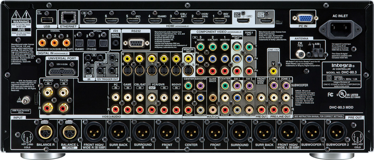

⭐ https://www.accessories4less.com/ma...-140-watts-thx-networking-a/v-receiver/1.html
I found that one ^ for a great discount. It's a monster receiver, very high-end, but no Dolby Atmos. With that receiver you don't need external amps, I can assure you, from personal experience.

I actually don't need the amplification from the AVR, the speakers chosen are active. a Pre/Pro may be the answer, they are usually more expensive than similarly featured AVR of the same brand. I do like the flexibility afforded by an HTPC. I prefer appliances and woudl like this system to be used by others...
Ok Frantz, a pre/pro, or an AV receiver used as a pre/pro...with preouts, like all the receivers I posted links of. They are all pre/pros too.

I looked up the LSR308, and it is balanced input. Best to go with a prepro with balanced outs, which is typical. AVRs don't usually have them, if any at all do. I like balanced better anyway, just for connection ergonomics, but they are also better for long cable runs, such as to the surround channels, and they often help avoid ground loops or other noise.

The system is almost complete. I have the Pre/Pro on order and it may take a month before it get them in my mediocre room. Same with the single LSR 308 (center channel), the 4 pairs of LSR305 ( Surround and back Surround). I have decided to go with 4 flat-pack Parts Express with a 15 inch HO Driver. Amplification for the subs will be courtesy of pair of Behringer iNuke 3000. Looking at the bill of material/components:
3 JBL LSR 308 ...... $450
4 JBL LSR 305 ......$500 ( I may reduce this I am not at all convinced that 7.1 provides much over 5.1
1 Pre/Pro INTEGRA DHC-80.3 9.2-Ch THX Networking A/V Preamp/Processor ....$525
4 Parts Express Flatpack subwoofer Bundle with 15" Driver ....$1100
2 Behringer iNuke 3000 ....$500
1 miniDSP 10x10 Hd ...... $600
1 Accessories, cables, connectors from Belden or other usual suspect Blue Jeans , Cnare ,etc .. $500 (perhaps less)
We're talking about a serious system capable on paper to hit reference levels within the audio band for the elevated expense of $4325 US .. Total cost will be a bit more once they are shipped here and clear Haitian customs. In the here and now I am happy about this...
