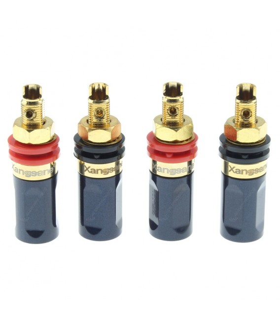

Is there a reason why the binding post holes have a funny shape?
Can I just make them round?
If you look at where the number 4 is, that is the section - between 3 and 4- that goes through the hole. On the bottom side, there is a little extra square, This is normally a little tooth that fits to the dent of the hole so that the pole doesn't turn around freely, what could jam or even make the inner cable break = You need to do the hole as indicated.
BTW if you are looking for reliable binding posts I love these ones
