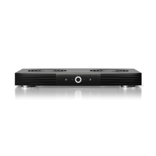

I placed this usb fan on top of my Buckeye Hypex NC502MP 2-Channel amp. Amp was a bit warm before, now stays at room temp while playing. No noise. Figure even with this little need for cooling, components will last longer.... I hope. Only $16
