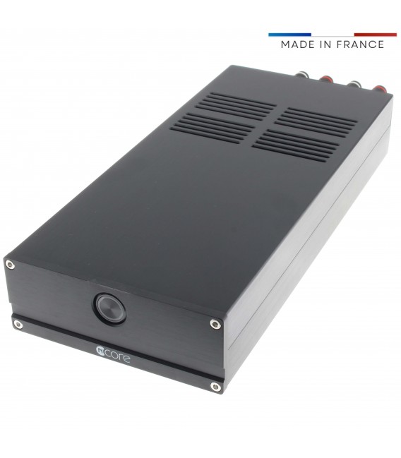

The enclosure is absolutely adorable! While it is fair bit deep, the other two dimensions are quite small. Combined with the low weight of the unit, you feel like buying a dozen to spread around the house and two to take on the road with you! :) The power button feels quite nice. The rear terminals exude quality and would rival and beat what you find on many expensive amplifiers:

Nice to see trigger input as well.

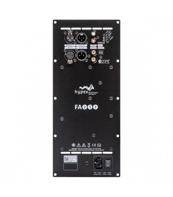

Inside a Hypex NC252MP amplifier module with integrated switching power supply. In use the bottom front got somewhat warm but nothing of concern. Protection circuit is robust and auto recovers from overloads.

Great to see the test results on this @amirm and to see this NC252MP has been implemented properly.
JSmith
There is an XLR version available too;
JSmith
There is not much to "implement". More like putting it in a box. That said those are amazing value for sure.

yeah i did kind of snort when i seen the 'made in france' tag
like i get it... i dont even mind this company at all given they are the cheapest option (I think?) and you are getting the same performance becuase all the boards come from the same factory in Malaysia to be screwed into a Ghent China sort of long case and then shipped...
same way a Renault SUV is made in Korea these days and is a rebadged Nissan.

Still, the infinite spray of mains harmonics suggests the wiring/grounding scheme could be improved and probably the XLR version has less of it. From the photo shown we can see that the form factor would have called for a 90° CCW placement for best cable routing.
But it could be mains contamination is intrinsic as the input section is really damn close to the power supply, not exactly best practice.

Exactly as expected performance (all-integrated NC252MP module) from a bargain classic !
Edit : Well, not "exactly". Burst power should reach 250W/4Ω/1%, tho.
@Audiophonics never said it was. ;) As for other NC-MP modules, in-house "implementation" design isn't a thing.

@amirm,
Perhaps you should specify in the title/review that this is the RCA version (maybe the reason why it has a touch less max power, because of insufficient input voltage?).
XLR:
RCA:
Above amps (NC502MP, NC500MP, NC500, NCx500...) have both XLR and RCA inputs:
Max power should reach 250W/4Ω/1%, tho.
It does. 1% is -40dB and it's right on the nose.
Also, minor variations in mains voltage will cause variations in measured output. The power supply in reality switches in a voltage doubler for US supplies.

Lots of empty space in there. I wonder if the long depth is for a rack mount? Or what?
