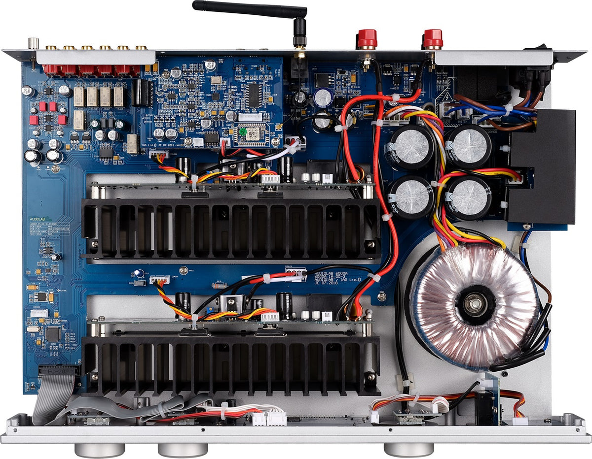

Hello. I would like to discuss the operation of a toroidal transformer in Audiolab 6000a. Not everyone may have noticed or experienced this problem, but if you have a poor electrical network, the transformer can hum and produce an unpleasant noise. This is an issue with any device that has a toroidal transformer. To solve this problem, there are DC blockers available for the electrical network. For example, this one from "Audiolab"

, whose price is clearly very high. Therefore, if you are knowledgeable in circuitry, you can build one yourself for around $10 in parts.
Alternatively, you can purchase a similar product which better than Audiolab and huge cheaper.

P.S. Don't let your transformers hum, protect your ears and your equipment :)
Hello. I would like to discuss the operation of a toroidal transformer in Audiolab 6000a. Not everyone may have noticed or experienced this problem, but if you have a poor electrical network, the transformer can hum and produce an unpleasant noise. This is an issue with any device that has a toroidal transformer. To solve this problem, there are DC blockers available for the electrical network. For example, this one from "Audiolab" View attachment 374020, whose price is clearly very high. Therefore, if you are knowledgeable in circuitry, you can build one yourself for around $10 in parts. View attachment 374021Alternatively, you can purchase a similar product which better than Audiolab and huge cheaper.
Example: https://www.aliexpress.com/item/1005005620982809.html
I find this funny because EMI filters are standard features in any half-decent SMPS...
You are right. But DC-block it's not an EMI filter. Last my link to AliExpress it's EMI+DC-block. And 6000a has a simple EMI filter inside the unit. But DC-Block is a filter of Direct current (DC).
A constant component in an alternating current (AC) network can arise due to the loading of the network with loads that contain significant nonlinearities, such as: switching power supplies for LED lamps, computers, and other office equipment, chargers, thyristor power controllers, and more.
As a result, the transformer core becomes saturated. This is particularly detrimental to toroidal transformers.
