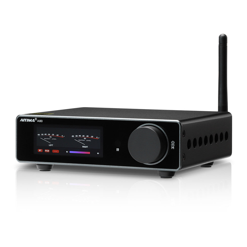

This is a review and detailed measurements of the AIYIMA A80 stereo amplifier and DAC. It was sent to me by the company and costs US $199.
As you can see, the A80 sports a nice sized graphical display showing one of the prettiest "VU" meters I have seen. It works well too by auto-ranging depending on how loud you play! I was pleasantly surprised to see a proper DAC integrated in it in the form of ESS ESS9038Q2M. You can see its feature set exposed in the back:
We have the usual DAC connections such as USB-0C, Toslink and Coax.
I am always pleased to see balanced inputs and we have that in the form of TRS. You can get simple adapter or cables from this to XLR.
Power supply as usual for this class is external. I tested with the 48 volt/5 amp GaN unit as supplied by the company.
We even have trigger input although with the included DAC, you won't need it.
Speaker terminals are just large enough to let me use my oversized locking banana plugs.
A remote is provided which is very nice.
Company has really nailed the functionality here. Let's see if it has good performance to go with it.
