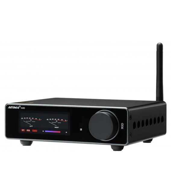

AIYIMA A80 Stereo Amplifier & DAC Review

Thank you for your review Amir. :) So a DAC, amp combo with included power supply for only US $199. Sounds good. It measures well, other than that it is a bit load dependent.
Maybe a stupid question but I'll ask it anyway. Does the remote control also control the volume? Reasonably, it should be so, but I take the opportunity to ask. :)

Many thanks for another interesting review, although I'm losing track of all the new wee amps (and dacs) coming out
We are getting spoiled (which is great) to the point where that load dependency almost looks odd now, even though it's probably not a real world problem (or feed it from a PC or WiiM and tweak that). Aggressive protection (also probably a good thing) and some channel imbalance.
It's not a beefy workhorse.
However: it's cheap, cute and really very good indeed. As a package, for that money, it's pretty great.
Usual caveat about early adopting, hopefully it turns out to be robust enough.

A little "swiss knife" for any desktop most installations.
Honestly wasn't expecting that blend of performances.
Thanks for the review @amirm !
170 watts per channel is medium to large room territory with a medium efficiency speakers..
What a gem at, likely, less than $200!!!
Amplification and DAC had already reached the commodity level. We weren't paying attention.
Triple WoW!
While it dosnt excite me , it's incredible what one can get for sod all these days . I'd like a PEQ tho , why not , it's super useful.
I'm still prefering seperate boxes including monoblock amps , putting amps next to speakers ( or in the speaker aka active ) , longer XLR and very short speaker wires .
The Dac lives in the source with a pre amp, Dacs in amps isn't for me.
looks like a great "all in one" for most people despite a few minor glitches that i probably won't hear anyway <12 KHz. :rolleyes:
Excellent value! Put it in a Hi-Fi shop and charge me $2000!
