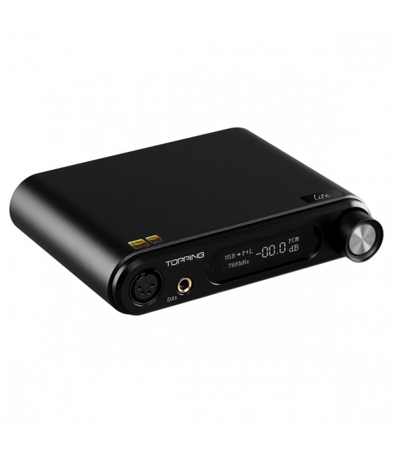

A slightly cheaper DAC:
This would allow you to get the more powerful amp within budget.
You'll need some TRS to XLR cables with that one:
