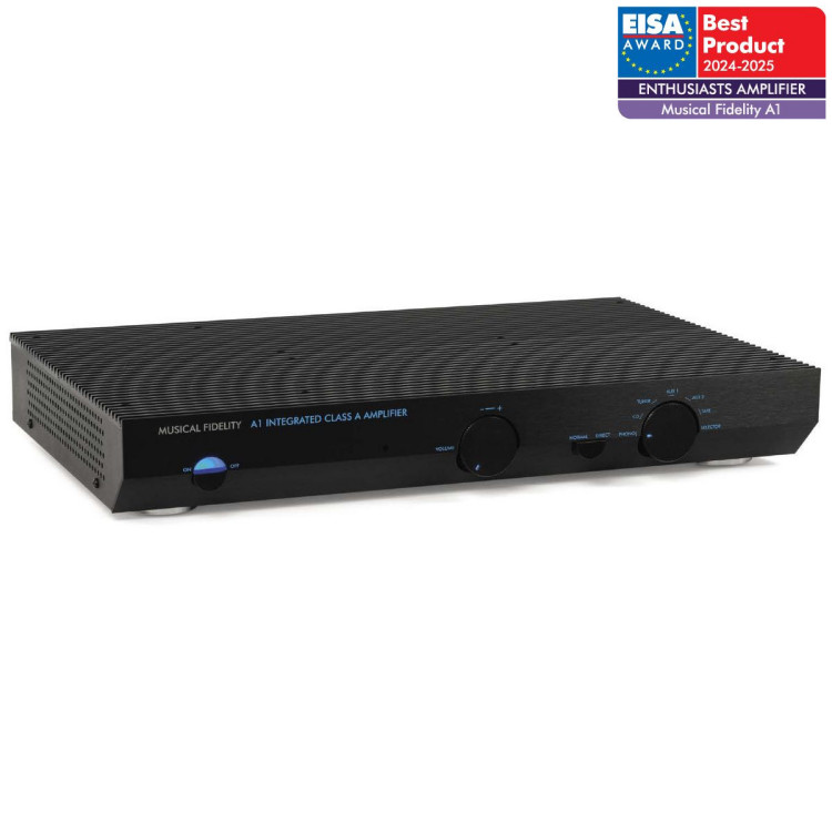

I didn't know they'd made an updated version of the A1; I wanted one of the originals, I thought that undercut facia looked cool, but never got around to it:
In any case I think you can get a lot more oomph for $1,500.00 these days - 25wpc is a bit anaemic.
Jesus, €1.650 for 25 W?
Check out the NAD C368 here
I also remember some of friends who had A1 amplifier complained that they might be able to cook egg fry on musical fidelity. They said it gets really hot.
Or another, even cheaper option NAD 316BEE V2.
I am not certain about the current version of A1 but the original would primarily make your room warm and the sound was anemic. I don't recall any other amp that would get that hot.

Well well well. I used to have a Musical Fidelity A1 many years ago. With the right music and the right speakers it was an absolutely glorious sounding amp. It didn't have much power and couldn't be used with inefficient speaker, but I recall listing through some SD Acoustics SD1 which had high efficiency (and other great attributes) and it was superb without qualifications. However it only really shone with easy going melodic music, and as soon as you needed some get up and go and aggression, it fell flat on it's face. It's the sort of amp that a valve lover would like.
The power distortion curves look dreadful, but that's not how it sounded. Anyone who thinks all amps sound the same should be made to listen one of these - it's an education point, and demands that you question the value of measurements.
I have very fond memories of that amplifier. Sade never sounded better, but ZZ Top never sounded worse. It's certainly a warm amp.
