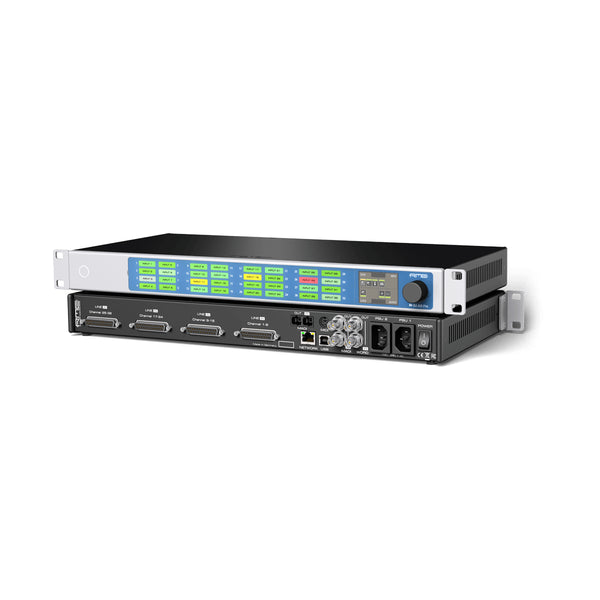

ferrofish seems like the perfect balance! I appreciate the feedback. it's grounding. I do believe there's some definite flavor and distortion that I'm chasing in the summing box. of course within the linear band +6db analog or digital will be the same but it's when I'm pushing the track into the orange where analog and digital begin to behave very differently. analog can sometimes sing, while digital screeches 10/10 times.

that box seems a little long in the tooth--the output count is perfect but I want to take full advantage of today's tech. I'm looking into whether RME does a newer version of this box. thank you!
As others ITT have noted, DACs and ADCs have been pretty transparent for years now... the past 10 years have not really advanced the state of the art AFAIK.
