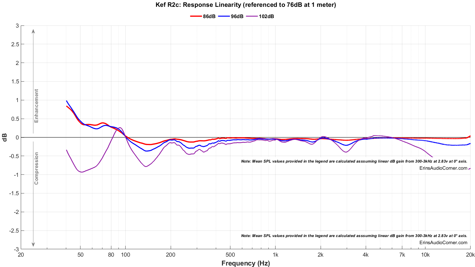

I'm guessing low frequency output of the meta version would be similar to the non-meta version.
It's around -20 dB at 30Hz so we're looking at an in-room output of 86dB at 30 Hz if we take the 96dB trend line.
Distortion at 96dB at 30 Hz seems to be just around 10%, which is really the maximum someone should aim at for low frequencies.
The idea is to pick a correct compromise of directivity (the 5.25 inch woofers will match the directivity of the 5 inch midwoofer better than the 6.5 inch woofers of the R6 meta) but also keep output and extension in mind for Dirac's new Active room correction that will inevitably end up in my room at some point.
What do you think? Should i go for the KEF R6 even though my listening levels will hover around 80-85 db 90% of the time? Or is that overkill? I'm sitting around 2 meters away from my speakers.
