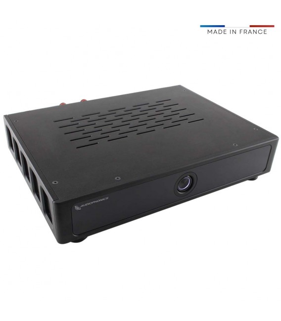

For the Elac Solano BS283, is this amp "enough" considering the speakers are 85 db/4ohm:
Or is this one more suitable:
I understand the latter can play louder and be better for bigger rooms but wondering if the nc252 would do the speaker justice in a smallish room with listening levels around 80-85db? The price difference is 150 euro (about 150 usd)

Lots of variables here but those speakers should be able to play at uncomfortably loud levels with both those amps not breaking a sweat, this approximates your general requirements:

I don't know if the 330VA transformer output is per secondary or total. If it's total, then it does seem underpowered and I'd like to see real measurements of maximum power at 1% THD. Given the speakers, even if it is underpowered, you likely would never go to the full volume of the amp.
You have 85dB sensitivity speakers. How big of a room or what listening distance are you at? For small spaces, a 100 wpc (at 4R) amp would be OK. The speakers are listed as "Nominal | Peak power handling: 70W | 100W" by elac. So, 70 wpc (nominal) at 85 dB sensitivity would be good out to maybe 2-3m, depending on the max volume you want to achieve. It should get loud (90-94 dB SPL), but not very loud. For average loudness (say 80s db SPL) it should be fine. I suspect if you throw the whole 165 wpc @ 4R of the YBA at those speakers, they will distort badly.
Based on this review, the elac might be closer to 84 dB sensitivity. Unfortunately, I did not see a THD vs freq vs power chart. https://www.i-fidelity.net/testberichte/hifi/elac-solano-bs-283/seite-5.html
I would save money on the amp and get one or two subs. For the YBA, given the integrated amp design, you cannot put a HP filter on the mains, but you do at least have the PRE OUT for subs. Get a measurement mic and REW to integrate the subs.
