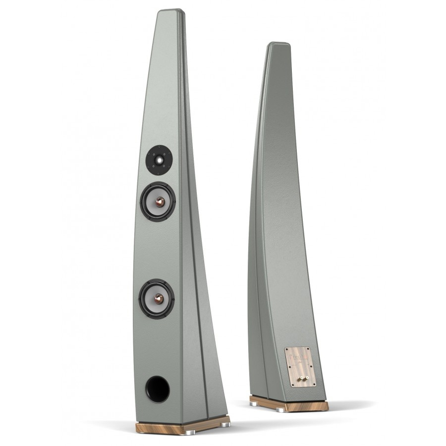

Not in the Stereophile measurements, I was particularly intrigued too and the off axis lateral response was one of the smoothest I have seen in a Stereophile review right up beyond 10kHz.
Not Dutch & Dutch 8C good but surprisingly close and very much more even than, for example, the hundred grand Von Schweikert Ultra 55.
I was surprised, as was @John Atkinson who measured them.
Did you look at that vertical response though?
